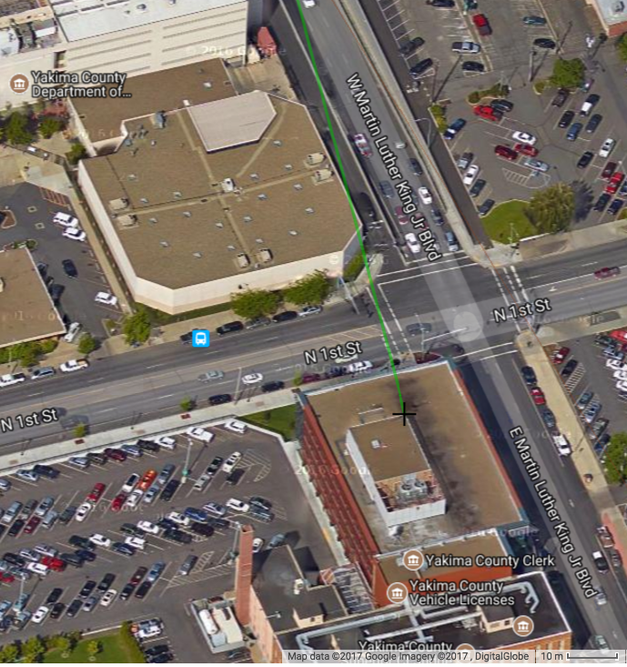

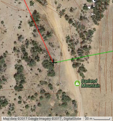

[image: Inline image 1]
Yakima County.
The Yakima County office is a 4 story+penthouse office building at 1st and
MLK.
Assuming it can see over the county jail across the street, it has a path
to Darland.
[image: Inline image 2]
Yakima EMD
It would also work equally well to the Yakima EMD office in Union Gap.
They have a nice tower there that looks like 100' tall.
Randy
W3RWN
