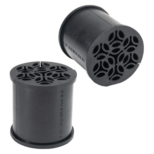

To address (2) I think we can look at stepping up to CAT6, which is AWG23 instead of AWG24, and has a larger outer diameter. The presence of a spline will also make the cable stronger.
This leaves us with a cushion problem, since our cushions are only designed for 1/4" cable and CAT6 is thicker than that. It seems we have gotten exceedingly lucky here! Valmont has just recently released a new cushion design that accepts 7 runs of 4mm-9mm cable! The part # is BCU158M7.
