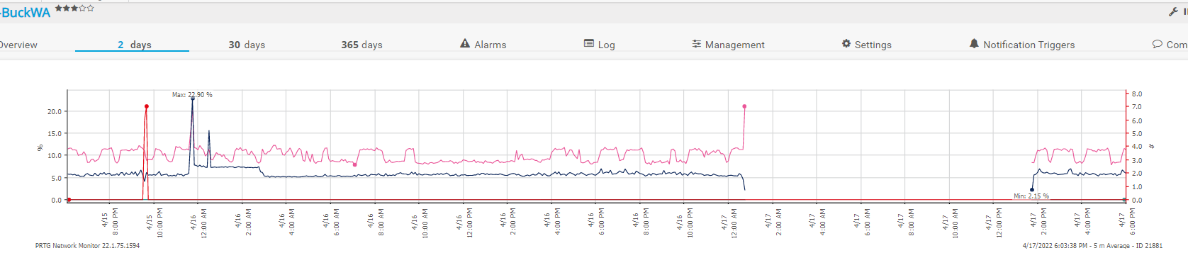

Is Buck Mtn down? My end seems to be working OK, but Cacti doesn't show any activity on Buck since the wee hours. 73, Dave K7DCJ
Something is up, the PtP link to Capitol Park is down. (that is the only link into the site right now) On Sun, Apr 17, 2022 at 10:27 AM David C. Jenner via PSDR <psdr@hamwan.org> wrote:
73, Dave K7DCJ _______________________________________________ PSDR mailing list PSDR@hamwan.org http://mail.hamwan.net/mailman/listinfo/psdr
Cacti shows no activity on Buck-CapPk since about 2am. That’s when it went down here. 73, Dave K7DCJ
On Sun, Apr 17, 2022 at 10:27 AM David C. Jenner via PSDR <psdr@hamwan.org> wrote: Is Buck Mtn down? My end seems to be working OK, but Cacti doesn't show any activity on Buck since the wee hours.
Sounds like the site lost power then, this HamWAN installation doesn't have UPS due to the limited space available to us. On Sun, Apr 17, 2022 at 11:06 AM David Jenner <djenner8@mac.com> wrote:

I can verify that the K7DK UHF repeater is also down. Must be a site wide power problem? 73, Dave K7DCJ

That seems logical. I have reached out to our hosts and asked if any of their equipment is also impacted. We haven't been able to-do a site visit/maintenance checkup in two years due to COVID, so hopefully it is just a site power issue. On Sun, Apr 17, 2022 at 11:18 AM David Jenner <djenner8@mac.com> wrote:

I have received confirmation from our host that power is certainly out at Buck and the site owner will be sending someone to investigate the issue. Thanks Kenny On Sun, Apr 17, 2022 at 11:22 AM Kenny Richards <richark@gmail.com> wrote:

Power was restored at 1400 this afternoon. Sent from my T-Mobile 5G Device Get Outlook for Android<https://aka.ms/AAb9ysg> ________________________________ From: PSDR <psdr-bounces@hamwan.org> on behalf of Kenny Richards <richark@gmail.com> Sent: Sunday, April 17, 2022 5:37:54 PM To: David Jenner <djenner8@mac.com> Cc: Puget Sound Data Ring <psdr@hamwan.org> Subject: Re: [HamWAN PSDR] Buck Mtn? I have received confirmation from our host that power is certainly out at Buck and the site owner will be sending someone to investigate the issue. Thanks Kenny On Sun, Apr 17, 2022 at 11:22 AM Kenny Richards <richark@gmail.com<mailto:richark@gmail.com>> wrote: That seems logical. I have reached out to our hosts and asked if any of their equipment is also impacted. We haven't been able to-do a site visit/maintenance checkup in two years due to COVID, so hopefully it is just a site power issue. On Sun, Apr 17, 2022 at 11:18 AM David Jenner <djenner8@mac.com<mailto:djenner8@mac.com>> wrote: I can verify that the K7DK UHF repeater is also down. Must be a site wide power problem? 73, Dave K7DCJ On Apr 17, 2022, at 11:12 AM, Kenny Richards <richark@gmail.com<mailto:richark@gmail.com>> wrote: Sounds like the site lost power then, this HamWAN installation doesn't have UPS due to the limited space available to us. On Sun, Apr 17, 2022 at 11:06 AM David Jenner <djenner8@mac.com<mailto:djenner8@mac.com>> wrote: Cacti shows no activity on Buck-CapPk since about 2am. That’s when it went down here. 73, Dave K7DCJ On Apr 17, 2022, at 10:50 AM, Kenny Richards <richark@gmail.com<mailto:richark@gmail.com>> wrote: Something is up, the PtP link to Capitol Park is down. (that is the only link into the site right now) On Sun, Apr 17, 2022 at 10:27 AM David C. Jenner via PSDR <psdr@hamwan.org<mailto:psdr@hamwan.org>> wrote: Is Buck Mtn down? My end seems to be working OK, but Cacti doesn't show any activity on Buck since the wee hours. 73, Dave K7DCJ _______________________________________________ PSDR mailing list PSDR@hamwan.org<mailto:PSDR@hamwan.org> http://mail.hamwan.net/mailman/listinfo/psdr<https://nam12.safelinks.protection.outlook.com/?url=http%3A%2F%2Fmail.hamwan.net%2Fmailman%2Flistinfo%2Fpsdr&data=04%7C01%7C%7C395aca47dd254efbd3ad08da20d3bc41%7C84df9e7fe9f640afb435aaaaaaaaaaaa%7C1%7C0%7C637858391017374845%7CUnknown%7CTWFpbGZsb3d8eyJWIjoiMC4wLjAwMDAiLCJQIjoiV2luMzIiLCJBTiI6Ik1haWwiLCJXVCI6Mn0%3D%7C3000&sdata=BtIraf52ydimW%2FVdu0gxDMA%2FVezYwCpACGo7i96hLoU%3D&reserved=0>
Well either the rack our gear is in didn't come back or something more local. I still am not able to access the PtP dish linking the site. On Sun, Apr 17, 2022 at 5:40 PM Jamie Hughes <wa7jh@outlook.com> wrote:

Yeah, my HamWAN is still down. Status of K7DK repeater is not known to me, I am now out of the area. I asked K7DK to please check it. 73, Dave K7DCJ

Jamie, I don't mean to conflict with Jamie's graph, since it appears he has access to the site owners monitoring for the building, but I just got another update from our host that other machines in the rack where the HamWAN equipment is located are still offline. Thanks Kenny On Sun, Apr 17, 2022 at 6:11 PM Jamie Hughes <wa7jh@outlook.com> wrote:

Sorry guys, Thought I’d offer some insight to the status of the site from a different perspective, my mistake. Thought I might offer a screen shot to show that shit was down between 0130 and 1330ish but has since been restored. So you know, OMG HAMWAN is down. 10:24 NOW PLAYING WATCH LATER ADD TO QUEUE (youtube.com)<https://www.youtube.com/watch?v=W8_Kfjo3VjU> I’ll STFU in the future. 73’s Jamie Hughes WA7JH Phone: (360) 340-8886<tel:+13603408886> From: Kenny Richards <richark@gmail.com> Sent: Sunday, April 17, 2022 6:19 PM To: Jamie Hughes <wa7jh@outlook.com> Cc: David Jenner <djenner8@mac.com>; Puget Sound Data Ring <psdr@hamwan.org> Subject: Re: [HamWAN PSDR] Buck Mtn? Jamie, I don't mean to conflict with Jamie's graph, since it appears he has access to the site owners monitoring for the building, but I just got another update from our host that other machines in the rack where the HamWAN equipment is located are still offline. Thanks Kenny On Sun, Apr 17, 2022 at 6:11 PM Jamie Hughes <wa7jh@outlook.com<mailto:wa7jh@outlook.com>> wrote: [cid:image001.png@01D85288.7E10CDD0] Jamie Hughes WA7JH Phone: (360) 340-8886<tel:+13603408886> From: PSDR <psdr-bounces@hamwan.org<mailto:psdr-bounces@hamwan.org>> On Behalf Of David Jenner via PSDR Sent: Sunday, April 17, 2022 6:09 PM To: Kenny Richards <richark@gmail.com<mailto:richark@gmail.com>> Cc: Puget Sound Data Ring <psdr@hamwan.org<mailto:psdr@hamwan.org>> Subject: Re: [HamWAN PSDR] Buck Mtn? Yeah, my HamWAN is still down. Status of K7DK repeater is not known to me, I am now out of the area. I asked K7DK to please check it. 73, Dave K7DCJ On Apr 17, 2022, at 6:05 PM, Kenny Richards <richark@gmail.com<mailto:richark@gmail.com>> wrote: Well either the rack our gear is in didn't come back or something more local. I still am not able to access the PtP dish linking the site. On Sun, Apr 17, 2022 at 5:40 PM Jamie Hughes <wa7jh@outlook.com<mailto:wa7jh@outlook.com>> wrote: Power was restored at 1400 this afternoon. Sent from my T-Mobile 5G Device Get Outlook for Android<https://nam12.safelinks.protection.outlook.com/?url=https%3A%2F%2Faka.ms%2FAAb9ysg&data=04%7C01%7C%7C7c2f11663ddc438f73c008da20d97cf7%7C84df9e7fe9f640afb435aaaaaaaaaaaa%7C1%7C0%7C637858415725856588%7CUnknown%7CTWFpbGZsb3d8eyJWIjoiMC4wLjAwMDAiLCJQIjoiV2luMzIiLCJBTiI6Ik1haWwiLCJXVCI6Mn0%3D%7C3000&sdata=aKRM8vC4hFGYmbbx%2Fqe3ZlAVWzRSIYiG5P81h%2FiGAxI%3D&reserved=0> ________________________________ From: PSDR <psdr-bounces@hamwan.org<mailto:psdr-bounces@hamwan.org>> on behalf of Kenny Richards <richark@gmail.com<mailto:richark@gmail.com>> Sent: Sunday, April 17, 2022 5:37:54 PM To: David Jenner <djenner8@mac.com<mailto:djenner8@mac.com>> Cc: Puget Sound Data Ring <psdr@hamwan.org<mailto:psdr@hamwan.org>> Subject: Re: [HamWAN PSDR] Buck Mtn? I have received confirmation from our host that power is certainly out at Buck and the site owner will be sending someone to investigate the issue. Thanks Kenny On Sun, Apr 17, 2022 at 11:22 AM Kenny Richards <richark@gmail.com<mailto:richark@gmail.com>> wrote: That seems logical. I have reached out to our hosts and asked if any of their equipment is also impacted. We haven't been able to-do a site visit/maintenance checkup in two years due to COVID, so hopefully it is just a site power issue. On Sun, Apr 17, 2022 at 11:18 AM David Jenner <djenner8@mac.com<mailto:djenner8@mac.com>> wrote: I can verify that the K7DK UHF repeater is also down. Must be a site wide power problem? 73, Dave K7DCJ On Apr 17, 2022, at 11:12 AM, Kenny Richards <richark@gmail.com<mailto:richark@gmail.com>> wrote: Sounds like the site lost power then, this HamWAN installation doesn't have UPS due to the limited space available to us. On Sun, Apr 17, 2022 at 11:06 AM David Jenner <djenner8@mac.com<mailto:djenner8@mac.com>> wrote: Cacti shows no activity on Buck-CapPk since about 2am. That’s when it went down here. 73, Dave K7DCJ On Apr 17, 2022, at 10:50 AM, Kenny Richards <richark@gmail.com<mailto:richark@gmail.com>> wrote: Something is up, the PtP link to Capitol Park is down. (that is the only link into the site right now) On Sun, Apr 17, 2022 at 10:27 AM David C. Jenner via PSDR <psdr@hamwan.org<mailto:psdr@hamwan.org>> wrote: Is Buck Mtn down? My end seems to be working OK, but Cacti doesn't show any activity on Buck since the wee hours. 73, Dave K7DCJ _______________________________________________ PSDR mailing list PSDR@hamwan.org<mailto:PSDR@hamwan.org> http://mail.hamwan.net/mailman/listinfo/psdr<https://nam12.safelinks.protection.outlook.com/?url=http%3A%2F%2Fmail.hamwan.net%2Fmailman%2Flistinfo%2Fpsdr&data=04%7C01%7C%7C7c2f11663ddc438f73c008da20d97cf7%7C84df9e7fe9f640afb435aaaaaaaaaaaa%7C1%7C0%7C637858415725856588%7CUnknown%7CTWFpbGZsb3d8eyJWIjoiMC4wLjAwMDAiLCJQIjoiV2luMzIiLCJBTiI6Ik1haWwiLCJXVCI6Mn0%3D%7C3000&sdata=kxrTLVu2DXosJQ2jUAnUTi2k8%2FZwR1uYhN%2FkWUjoTvY%3D&reserved=0> _______________________________________________ PSDR mailing list PSDR@hamwan.org<mailto:PSDR@hamwan.org> http://mail.hamwan.net/mailman/listinfo/psdr<https://nam12.safelinks.protection.outlook.com/?url=http%3A%2F%2Fmail.hamwan.net%2Fmailman%2Flistinfo%2Fpsdr&data=04%7C01%7C%7C7c2f11663ddc438f73c008da20d97cf7%7C84df9e7fe9f640afb435aaaaaaaaaaaa%7C1%7C0%7C637858415725856588%7CUnknown%7CTWFpbGZsb3d8eyJWIjoiMC4wLjAwMDAiLCJQIjoiV2luMzIiLCJBTiI6Ik1haWwiLCJXVCI6Mn0%3D%7C3000&sdata=kxrTLVu2DXosJQ2jUAnUTi2k8%2FZwR1uYhN%2FkWUjoTvY%3D&reserved=0>
Our site host was notified that American Tower sent a crew up last night and power was restored very early this morning. I am able to access the main router and it seems that David's client is connected again. Thanks Kenny On Sun, Apr 17, 2022 at 6:26 PM Jamie Hughes <wa7jh@outlook.com> wrote:
Sorry guys,

*From:* Kenny Richards <richark@gmail.com> *Sent:* Sunday, April 17, 2022 6:19 PM *To:* Jamie Hughes <wa7jh@outlook.com> *Cc:* David Jenner <djenner8@mac.com>; Puget Sound Data Ring < psdr@hamwan.org> *Subject:* Re: [HamWAN PSDR] Buck Mtn?
Jamie,
