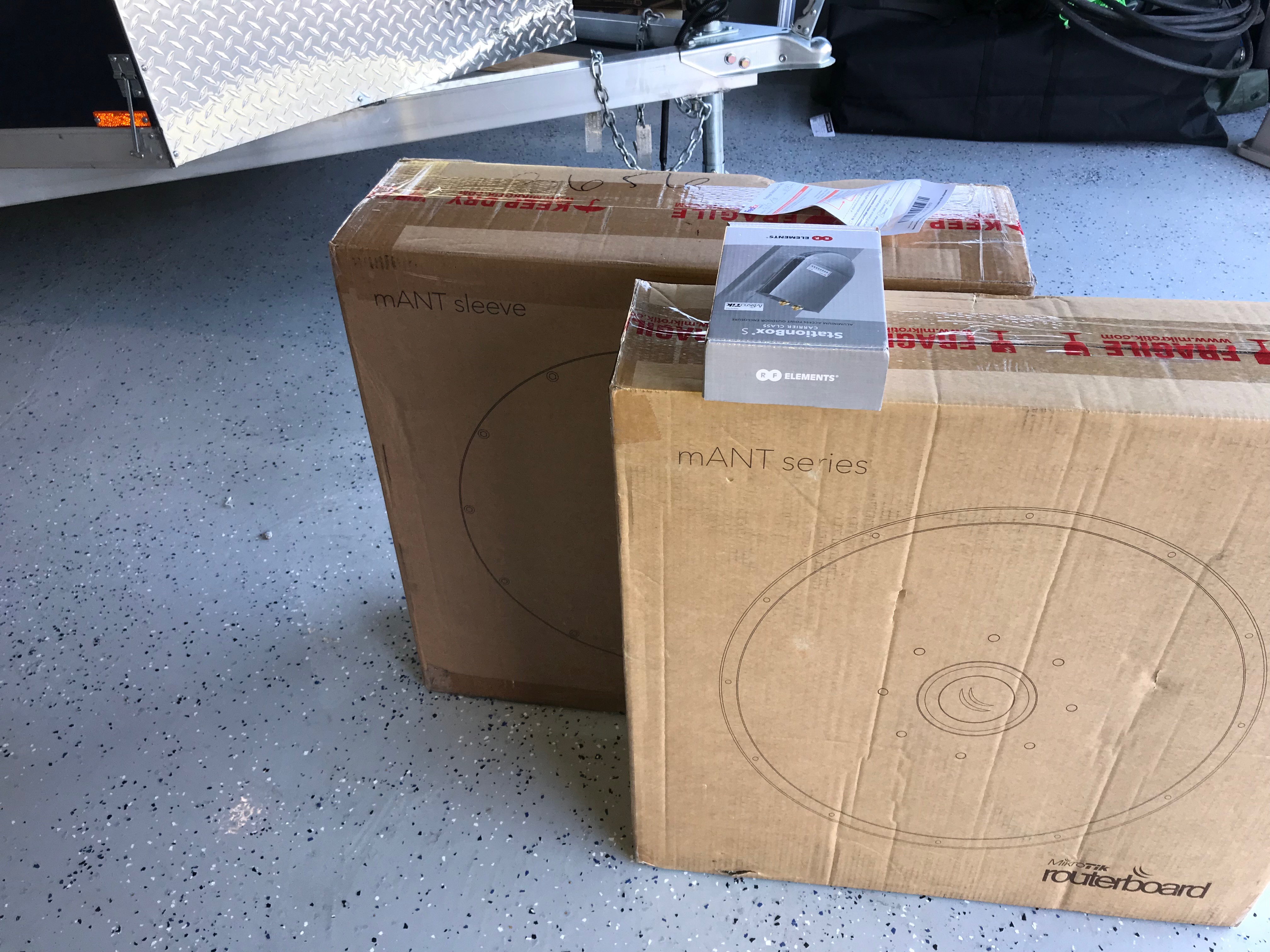

All parts have arrived for the 2nd EOC link to Beacon and are now in the Burien Warehouse. Doug, KD7DK and I W3RWN are donating this jointly to Seattle ACS to get the EOC diversely connected to HamWAN.

Hi John, We would be happy to help you get the Vashon Island EOC connected to HamWAN, and hope that you might get a VoIP Telephone so that you can join in on the HamWAN VoIP voice network. We have VoIP phones in Seattle EOC, and our friends in Snowhomish Co EOC have VoIP phones as well. Our goal is to get Camp Murray with HamWAN and VoIP phones soon. Re Equipment... I like the Mikrotik DynaDish5-International radio and antenna. It has good gain, less parts to assemble, and seems durable. At Seattle EOC we are on the HamWAN backbone, so we have high performance antennas. Mikrotik mANT30 2ft 30dBi dish Mikrotik Sleeve30 shielding (if you have more than one HamWAN or 5GHz link at your location) Mikrotik RouterBoard RB912UAG-5HPnD-OUT (radio with weatherproof box) or Mikrotik RouterBoard RB912UAG-5HPnD (radio board, no case) RF Elements Station Box SBX-S-CC-2SMA (case for above) Best, Randy, W3RWN Member of: Seattle ACS Highline ARC West Seattle ARC Puget Sound Repeater Group HamWAN On Mon, Sep 17, 2018 at 6:15 PM John V. Cornelison <john@vashonsoftware.com> wrote:
