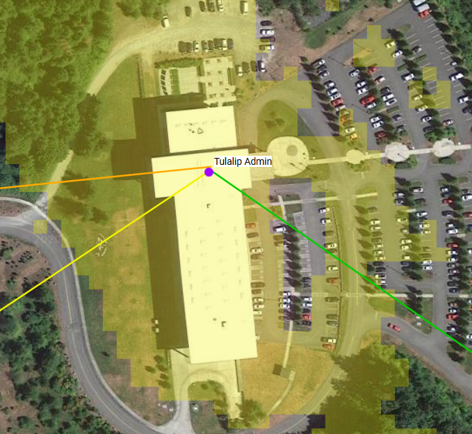

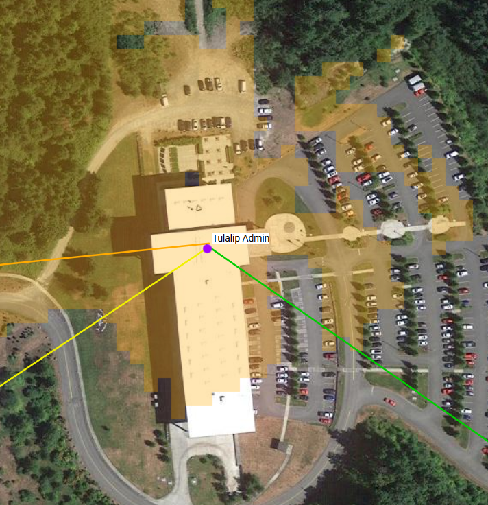

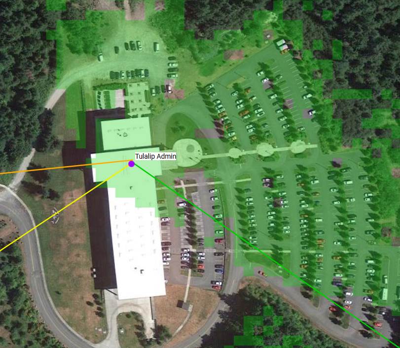

We're putting up a PNWDMR repeater at the Tulalip Admin building (48.0550477,-122.2585515) but due to the way the building is we can't point south. Does anyone know if there is a PSDR site that we can hit looking north-ish? Thanks and 73, Joe -- Joe Hamelin, W7COM, Tulalip, WA, +1 (360) 474-7474
Still need to do elevation profiles and a lot of it will depend on the height of building vs surrounding trees. Also need to look at total loss and distance, and the actual position on the building will make a difference for Haystack and Buck, but here are your possibilities so far: Blyn (yellow shading, orange line) Buck Mountain (yellow shading, yellow line to SW) Haystack (green shading, green line) From: PSDR [mailto:psdr-bounces@hamwan.org] On Behalf Of Joe Hamelin Sent: Monday, October 5, 2020 8:04 PM To: Puget Sound Data Ring Subject: [HamWAN PSDR] Heat map for Tulalip site. We're putting up a PNWDMR repeater at the Tulalip Admin building (48.0550477,-122.2585515) but due to the way the building is we can't point south. Does anyone know if there is a PSDR site that we can hit looking north-ish? Thanks and 73, Joe -- Joe Hamelin, W7COM, Tulalip, WA, +1 (360) 474-7474
Thanks Rob, It looks like we'll have to try Blyn. We're relegated to the north third so it looks like we can just make it there. Next Monday we'll go up with a dish and try it. -Joe -- Joe Hamelin, W7COM, Tulalip, WA, +1 (360) 474-7474 On Mon, Oct 5, 2020 at 8:22 PM Rob Salsgiver <rob@nr3o.com> wrote:
*Blyn (yellow shading, orange line)*
*Buck Mountain (yellow shading, yellow line to SW)*
*Haystack (green shading, green line)*
