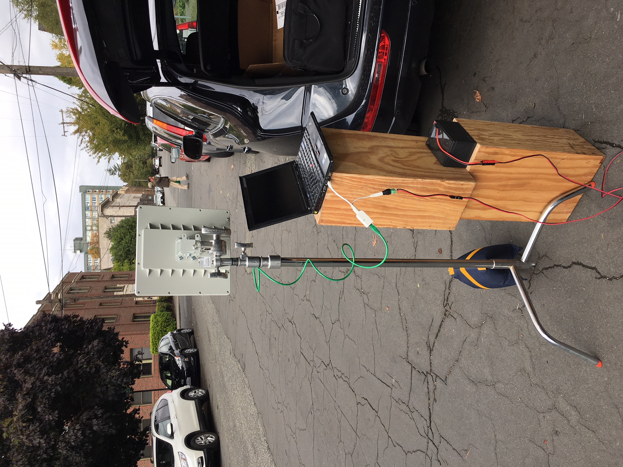

I have installed two LHG5s. They work well in a sheltered environment. The reflector is akin to chicken wire coated with plastic! It is uncertain to me how long these would last outdoors. 73 Dan Ransom, PE (509) 330-6398

Hi Tom, Thanks for the quick response. That would be super if I could reach the Haystack site. Our little community would be quite cut off without power in the event of an earthquake or even something as common as a heavy snow. My hub team is investigating solutions for emergency comms beyond feebly attempting to use voice to convey ICS-213 forms. It sounds like you have something great working already and I'd love to see if it could work for us.
I'd like to see if it would work at all, with minimal investment. We have a community council with funds to buy equipment if a proof of concept test works out. What would be your recommended kit for seeing if we could make contact? From your online PowerPoint docs, I've read that the Microtik hardware is super hard to configure, but that the Ubiquiti is far easier to set up for people who are not network transport layer engineers. Bob

I could use a hand from a HamWAN skilled person. I have the hardware and have gone through all the setup steps and that all went just fine. The router can ping google.com and seems to be happy enough connected to CapitolPark. But, I just can't get my Windows laptop to use the connection on it's own. I must be missing something key, but I followed all the steps to the letter. Here's some snaps of what I'm seeing, plus a picture of my mobile HamWAN setup. Bob On Mon, Oct 2, 2017 at 3:27 PM, Robert Edmiston <kg7ucl@gmail.com> wrote:

I'm up and running on hamwan. Special thanks to Carl Leon with good info about installation details and to Tom Hayward who worked through the dark arts of router config details. I'm now able to connect one laptop to the router and bring up hamwan.org and click through the pages. Next steps are to figure out what's possible with hamwan without running afoul of the no-encryption rule. One day, perhaps I can contribute a page to the website listing useful scenarios and tools I've found to work. Thanks for this awesome service. Bob Edmiston KG7UCL Madison Park HUB. On Mon, Oct 2, 2017 at 3:27 PM, Robert Edmiston <kg7ucl@gmail.com> wrote:
