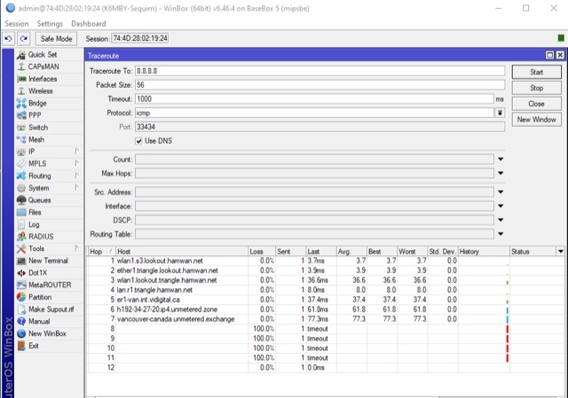

Good day, Have a problem that I am not sure where to go for support. I have a client node off Lookout in Sequim, WA. Until a few days a go it worked flawlessly serving DMR, packet 1200, VARA FM and VARA HF. The client HamWAN hardware is still connected to Lookout but I am unable to get service for the attached services. Going to tools and using traceroute to 8.8.8.8, as and example, I only get so far before there is a 100% failure… I am certainly a noobe when it comes to poking around the the router so any help would be appreciated. And yes, I did restart to HamWan router. ================ Bob Sampson k6mby@olypen.com 360-477-0776 (cell) Sequim, WA
Looks like our upstream ISP in Vancouver BC may have enabled source address filtering, Let me have a look. Right now traffic from Lookout hops over to Triangle and then tunnels out to Vancouver and hops out to the Internet from there. Chris On 13/07/2020 13:30, Bob Sampson wrote:

Have a problem that I am not sure where to go for support. I have a client node off Lookout in Sequim, WA. Until a few days a go it worked flawlessly serving DMR, packet 1200, VARA FM and VARA HF. The client HamWAN hardware is still connected to Lookout /but I am unable/ to get service for the attached services. Going to tools and using traceroute to 8.8.8.8, as and example, I only get so far before there is a 100% failure…

Hi Bob, Can you confirm that Internet traffic is working for you again? I just created some routing rules to force the ham traffic to hop over to the PSDR edge at the Westin and confirmed things at the Triangle side are looking good: 1 lan.r1.triangle.hamwan.net 0% 17 0.4ms 0.4 0.4 0.5 0 2 er1-van.int.vidigital.ca 0% 17 15.1ms 18.8 15.1 26.5 3.5 3 ipip7.er1.seattle.hamwan.net 0% 17 18.9ms 21.5 18.9 36.3 4.5 4 209.189.196.65 0% 17 20.5ms 23.8 20.1 32.5 4 5 ge0-0-0-1-thbr05.threshinc.net 0% 17 19.6ms 23.9 19.6 41.3 4.9 6 pr02-ae12.sea09.net.google.com 0% 17 20.3ms 21.8 19.5 26.5 2.1 7 108.170.245.113 0% 17 20.9ms 21.9 18.9 30.9 2.9 8 108.170.233.155 0% 17 23.5ms 21.5 19.1 30.4 2.8 9 dns.google 0% 17 27.6ms 21.4 18.9 27.6 2.6 Chris On 13/07/2020 13:38, Christopher Munz-Michielin wrote:
