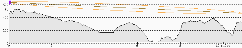

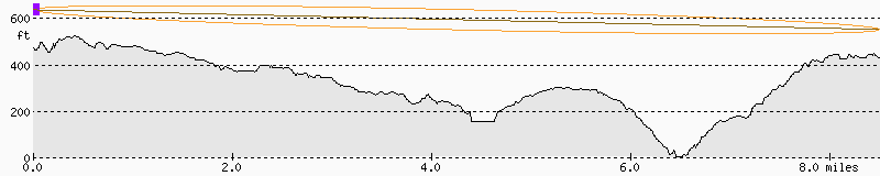

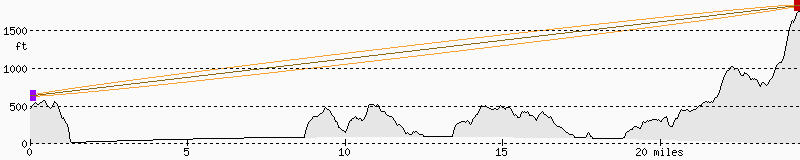

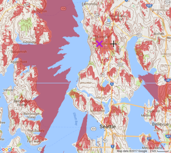

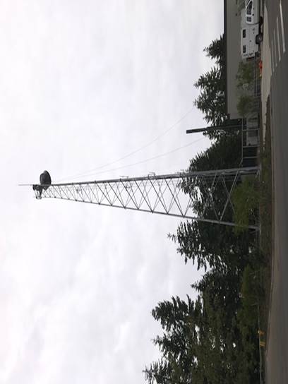

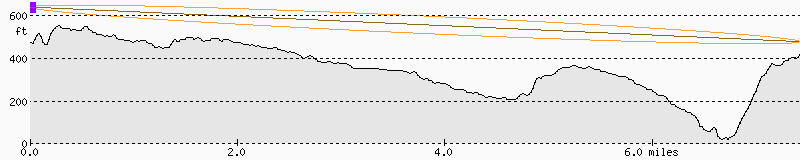

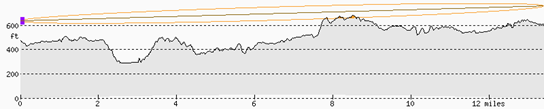

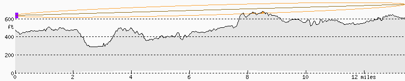

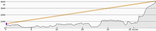

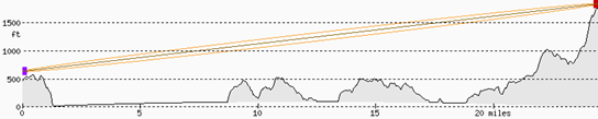

Saw some riggers working on a newish looking 160' lattice tower at the Wash. DOT Traffic Management Center in south Shoreline, just a bit north of the Seattle/Shoreline boundary. Not sure if the State is a willing host, but I ran a few plots thought it was interesting enough to drop a note here. Looks like the site has generators and is something like an EOC for managing the freeway traffic. 15710 Dayton Ave N, Shoreline, WA) 47.744256 N / 122.351849 W Ground 470' AMSL Tower 160' Self Support [image: Inline image 8] 7 Miles @180 Deg to Queen Anne PSRG [image: Inline image 3] 13 Miles @22 Deg to Paine [image: Inline image 2] 8 Miles @168 Deg to Capital Park [image: Inline image 4] 11 Miles @ 171 Deg to Beacon Hill [image: Inline image 5] 24 Miles @237 Deg to Gold [image: Inline image 6] 29 Miles @81 Deg to Haystack [image: Inline image 7] [image: Inline image 9] Randy W3RWN
