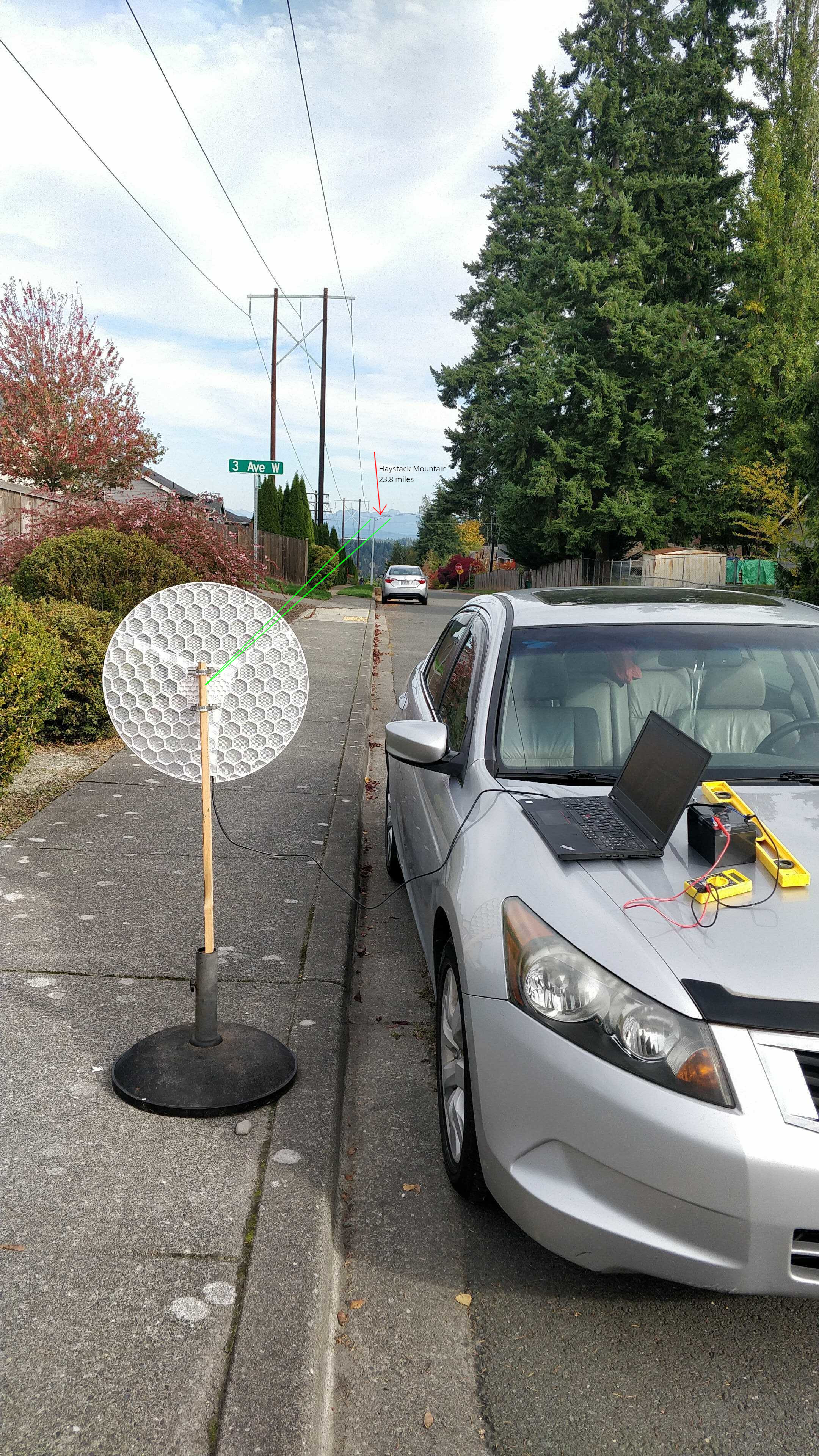

I've had success with the MikroTik XL HP5 dish, which I really really like. It has a gain of 27 dBi. I have been able to get a signal at close range when some obstruction were in the way, but it was very slow. I too was initially overly optimistic and misunderstood its tolerance (5 GHz WiFi goes through walls, what's the issue?) but at long ranges it really needs to be be visible. I've attached a picture of my first link to Haystack using the dish, just about 24 miles distance. The dish is stabilized with a small piece of wood from Lowe's and a patio umbrella stand. I'm sure the signal goes through some wires or that distant pole, but that's acceptable. Jesse KJ7YLS Sent from ProtonMail mobile \-------- Original Message -------- On Nov 2, 2021, 12:57 PM, Mark Hartman < enochianborg@gmail.com> wrote:
