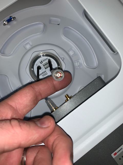

I'm not clear what the issue is here. No jumpers or other additional cables are necessary.The Ubiquity antennas (both the regular and LW dishes) connect directly to Mikrotik radios. The antenna is a RP-SMA M, the 912 is RP-SMA F. I've got exactly this setup on a bench right now that I'm playing with for some other projects. The only other change here is that the 912 5HP is in a RF Elements StationBox. But that's just an enclosure... Pics or it didn't happen:
