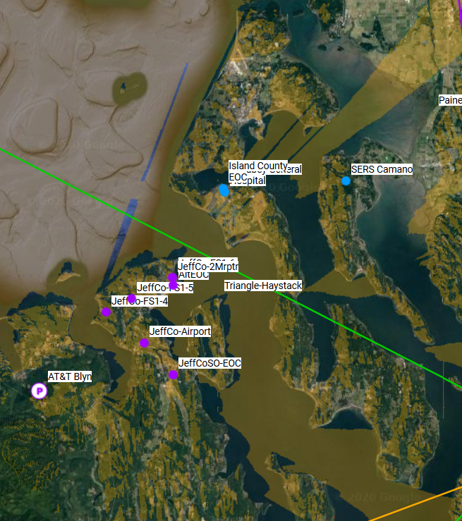

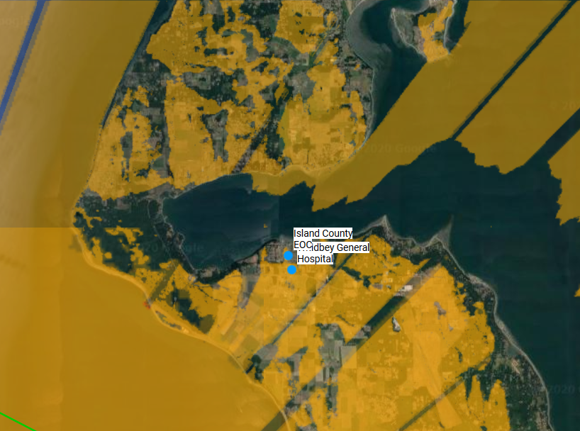

Here is a wide-angle look at the starting coverage from Blyn with a zoom in on the Coupeville/Oak Harbor area below. Coupeville / Oak Harbor If folks want to send me coordinates and names of locations I can add them to the map(s). Rob

If you can share the sector antenna heights and azimuths for Blyn and Rattlesnake, I can generate coverage plots like we have on the website. Looking through the archives, all I was able to find was the lat/lon and that the sectors were "rotated counter-clockwise slightly". Tom On Tue, Jul 7, 2020 at 3:56 PM Rob Salsgiver <rob@nr3o.com> wrote:

Rattlesnake sector height is...I dunno, 140ft? S1 is aimed roughly 340, S2 is aimed roughly 95. Blyn S1 and S3 are 90ft. S1 is @ 0, and S3 is roughly 260. S2 is not mounted yet, and it will go lower than 90ft. S1+S3 are not cabled yet. --Bart On 7/9/2020 8:13 AM, Kenny Richards wrote:
