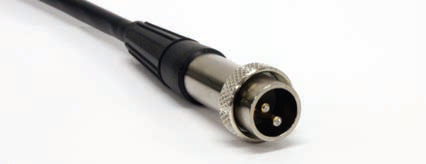

That looks like a home run. You sir, are awesome, and all of PSDR should know it! :) http://www.farnell.com/datasheets/1520321.pdf 80-MC2M (male plug) mates with 80-PC2F (female panel mount receptacle). A little pricey @ $18.91 and $14.86 each respectively at newark.com, but still far better than not having connectors! Problem: Solved! Now for the next trick: avoiding $123 rotary switches. Need at least 8-position, 3-deck, single pole per deck. Minimal currents/voltages involved. After that, the rest of the components are cheap and easy. Just like me. --Bart On 10/29/2012 04:16 PM, Dan Camp wrote:

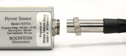

They're also used on the backs of the power sensors:
The male end looks like this:
And they mate like this:

Can anyone find females + males of these? More precisely, I'd like a panel-mount female (receptacle) and a couple in-line (attached to cable) male plugs. A pre-assembled jumper with male ends would work too. It would also be awesome to find an adapter from this weird standard into something more readily available.
Any suggestions?
