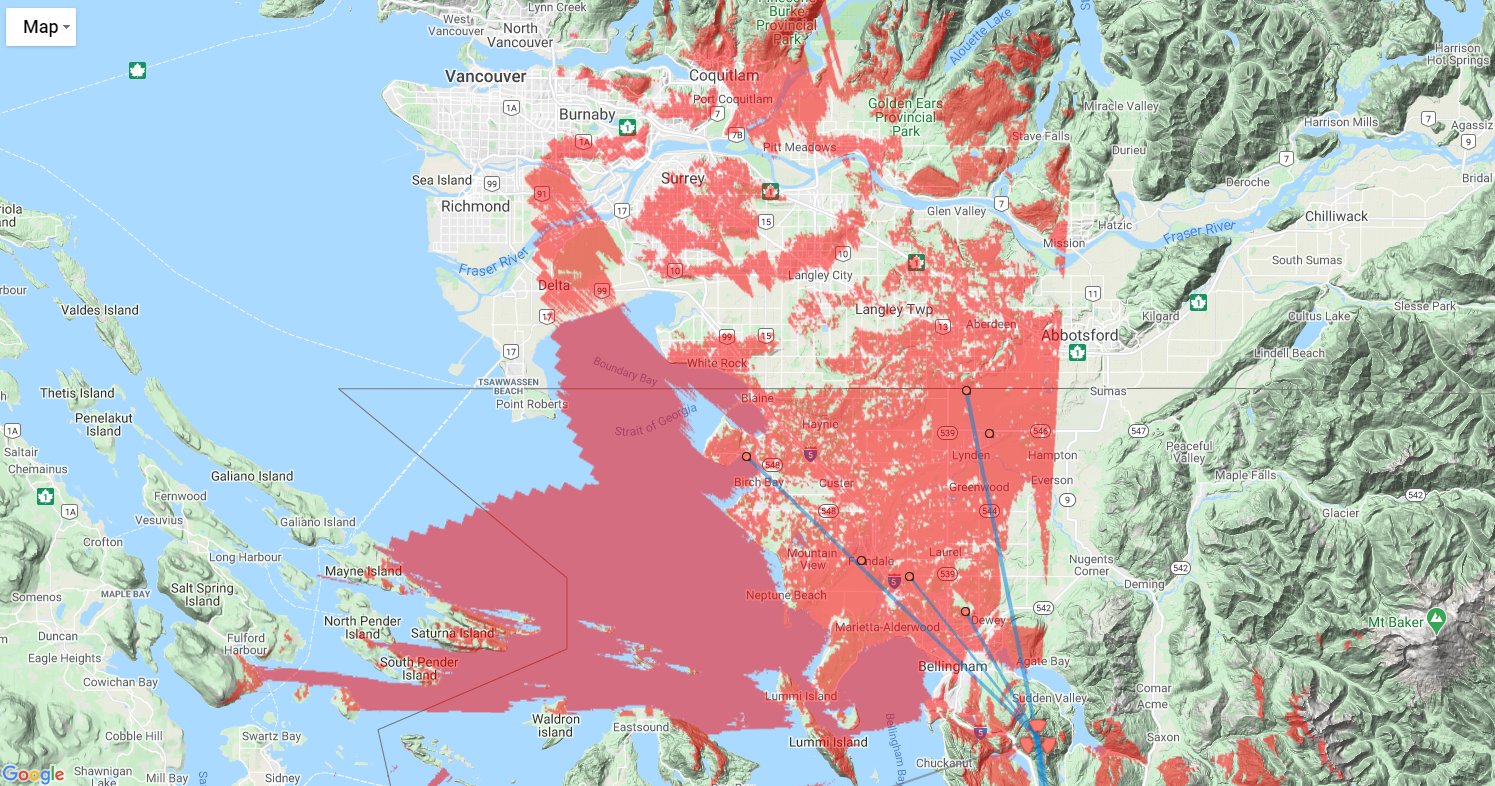

There are 3 sectors on Lookout Mtn. approximately covering this area [image: image.png] On Wed, Mar 10, 2021 at 5:39 PM Scott Leaf <scott.e.leaf@gmail.com> wrote:

I have purchased the recommended Mikrotik radio and 30db dish, programmed it and I do see the Hamwan channels in the Scan
I am shown in the HamWan coverage area according to the coverage map and I can in fact see Lookout Mtn from where I am at 120M elevation here in Maple Ridge BC.
Used to connect to the 900 Mhz repeater there with a handheld on low power from here. Dont think the QTH is the problem.
Took the dish and laptop up to do a ballpark test before permanent install but I am getting no signals on the HamWan channels. When I switch to Wifi I get dozens and dozens so it is working.
Rotated dish 90 degrees just in case I had the polarity wrong, still nothing.
Suggestions please.

Does the map show you fall within coverage area? https://hamwan.org/ <https://hamwan.org/> On Wed, Mar 10, 2021 at 5:52 PM Jamie Owens <jlowens76@gmail.com> wrote:

I can confirm that sector 1 (the one pointing north) is up and has active connections. -Doug- On Wed, Mar 10, 2021 at 6:00 PM Stephen Kangas <stephen@kangas.com> wrote:

Indeed I am connected to sector 1 in this area, although we did have to lock it to sector one only because it was always trying to hop to sector 3 with a weaker signal. [image: image.png] On Wed, Mar 10, 2021 at 6:03 PM Doug Kingston <dpk@randomnotes.org> wrote:
