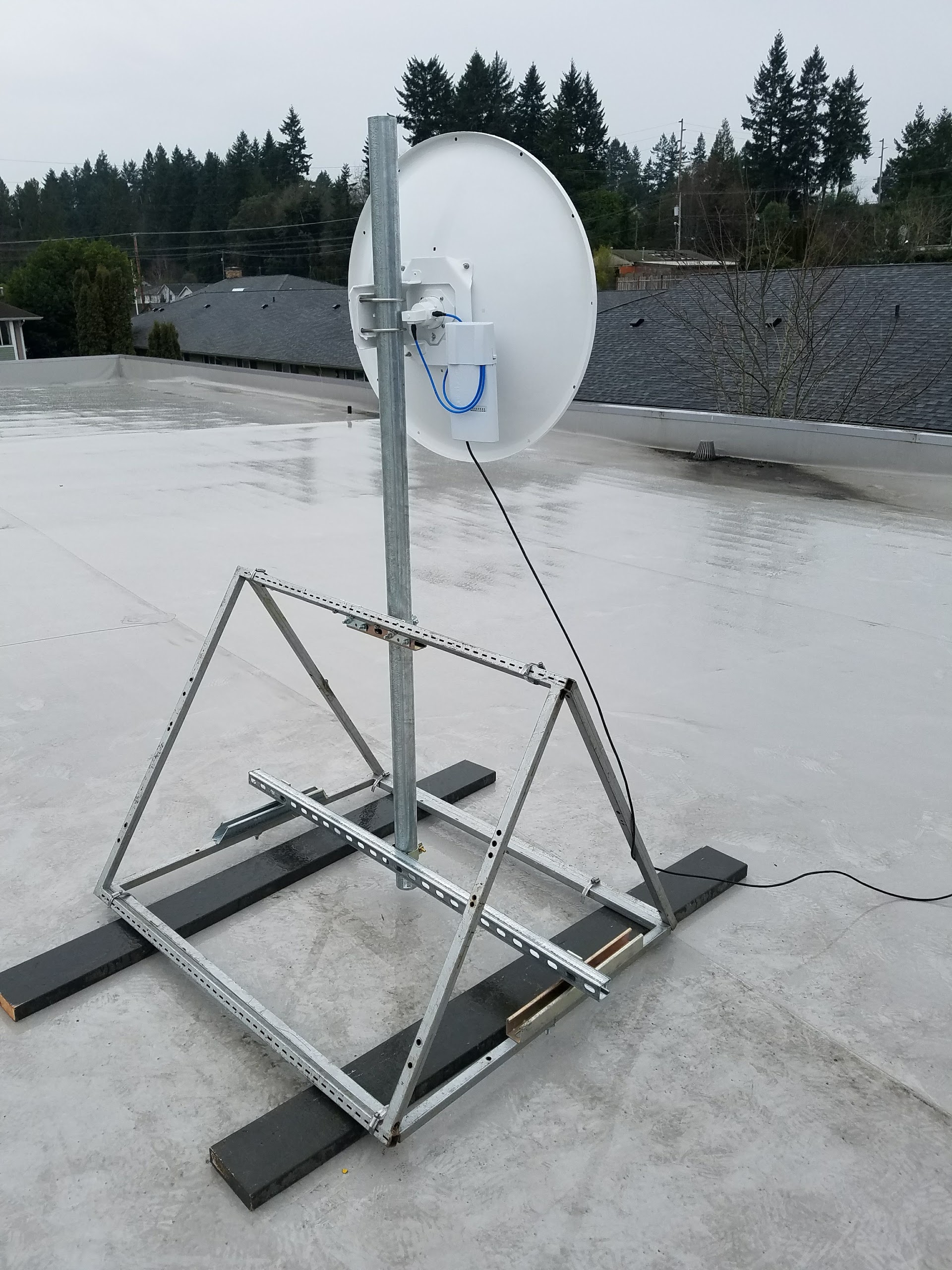

Let us know how the LHG 5 works, $54 sounds fantastic, much cheaper than my rig. This setup worked really well for me, just powered up on Friday: $80 Mikrotik BaseBox 5 RB912UAG-5HPnD-OUT 5GHz Outdoor Wireless AP Gigabit USB OSL4 http://a.co/9U1koAm $150 MikroTik mANT30 parabolic dish antenna 5GHz 30dBi MTAD-5G-30D3 http://a.co/01zPgMP ---- but I strongly recommend buying the version with the precision alignment kit. The correct part number ends in "-PA" The base is made out of some scrap material, unistrut, and a 6' fence post. Use a level to plumb the mast before hanging the dish. With MIMO gear, your feed's vertical and horizontal axes need to be plumb and level. Make sure your gear is MIMO compatible. KI7SBI Dylan On Sun, Jan 7, 2018 at 10:07 PM, Mark Tellez <mark.tellez@gmail.com> wrote:

BC Internail HamWAN (http://www.hamwan.ca) uses the LHG5, the LHG5HP and the LHG5HP-XL for a large number of the clients. So far the experiences have been good. I would not recommend this combination at a high-level site where it may be exposed to icing etc as they have nowhere near the same build quality as the mANT-30's (plastic mesh vs all metal etc) On Mon, Jan 8, 2018 at 11:30 AM, Dylan Ambauen <dylan@ambauen.com> wrote:
KI7SBI Dylan
