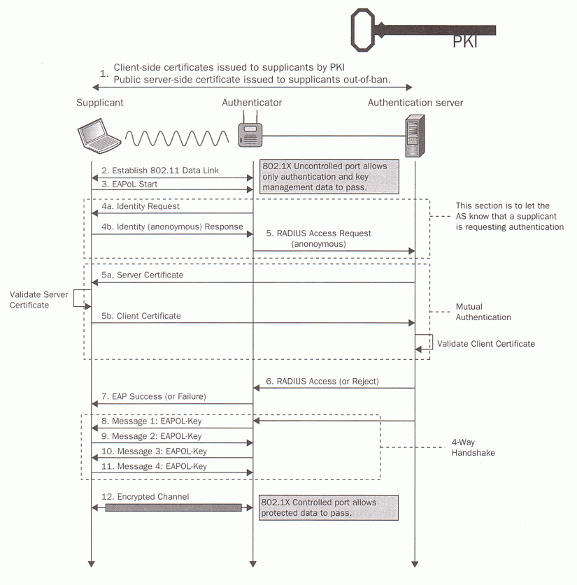

So here's the thing, I can't seem to find a way to do 802.1x or 802.11i or WPA2-EAP or EAP-TLS, whatever you wanna call it, without the gear actually setting up an encrypted tunnel between the STA and the AP. I can't see a way to use a null cipher here or to disable the tunnel creation phase after the authentication has succeeded. We can't even say "OK we'll publish the keys" because the keys are dynamically generated. Here's a good picture of EAP-TLS:
http://cwne88.files.wordpress.com/2012/08/eap-tls.gif
And here's the 4-way handshake details: http://en.wikipedia.org/wiki/IEEE_802.11i-2004#The_Four-Way_Handshake
If we could just stop at step 6 or 7, life would be grand! This is looking impossible, sirs.
