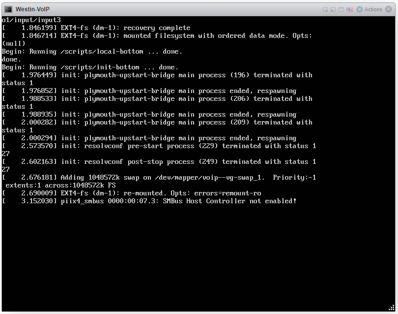

First it froze, then it was rebooted and the HA software screwed up somehow, then HA software was bypassed and it ran for a few days, then it ran out of RAM and deadlocked, then I rebooted it and gave it more RAM, and then it refused to boot up at all. It's been an ordeal of Ubuntu 14. It needs to be either rescued via Live CD or rebuilt from scratch at this point, since it's not booting. If anyone has an insightful idea for dealing with this frozen boot screen, it'd be great: --Bart On 5/2/2022 7:05 PM, Carl Leon wrote:

OK, looks like I have it working. To fix it, I disabled drbd, since there is no HA failover peer anymore to share files with. drbd was blocking boot process. I also disabled pacemaker, which was preventing asterisk from communicating with the outside somehow. I migrated the pacemaker anycast IPs directly into Ubuntu eth0:0 and eth0:1 aliases. Verified my phone registers now, and can get into the conference call service. Since I basically ripped out HA to make this work, I'm gonna disable a few more services to optimize / speed up the boot process. Corosync and ha_logd and whatever else. Things will be back for good in a few more reboots. --Bart On 5/2/2022 7:12 PM, Bart Kus wrote:

I'm done putzing with it. It boots quickly now. I've also added open-vm-tools so that the shutdowns / reboots are clean, and we can see all the bound IPs. Also took a couple snapshots in case we need to restore in future. --Bart On 5/2/2022 8:24 PM, Bart Kus wrote:

Thanks Bart for getting this back to a working state. Things look good here. -Doug- On Mon, May 2, 2022 at 8:57 PM Bart Kus <me@bartk.us> wrote:
