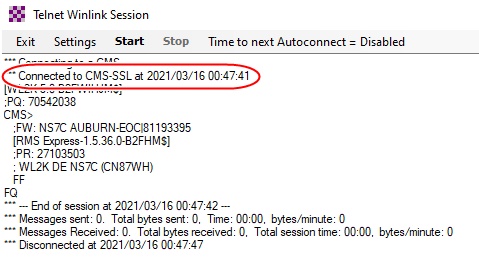

[image: Winlink SSL.jpg] Winlink Express Link Test: Test started 2021/03/16 00:52 UTC
Testing CMS telnet connection to cms.winlink.org through port 8772... Successfully connected to a CMS through port 8772 in 253 Milliseconds
Testing CMS SSL telnet connection to cms.winlink.org through port 8773... Successfully connected to a CMS through port 8773 in 311 Milliseconds
Testing API service access through port 443 to api.winlink.org... Successfully performed API service to api.winlink.org through port 443 in 756 Milliseconds
Testing Autoupdate server access through port 443 to autoupdate2.winlink.org... Successfully checked autoupdate server through port 443 in 439 Milliseconds
Testing connection to web site - www.winlink.org:443 Successfully connected to www.winlink.org through port 443 in 47 Milliseconds
Testing FTP connection to SFI site - ftp://ftp.swpc.noaa.gov/pub/latest/SGAS.txt Successfully connected to ftp://ftp.swpc.noaa.gov/pub/latest/SGAS.txt through port 20/21 in 1522 Milliseconds
Test completed successfully. -Scott, NS7C

That was a test on my home Internet, but they would be if you started a telnet session over HamWAN.... On Mon, Mar 15, 2021 at 9:16 PM John D. Hays <john@hays.org> wrote:
Are those over the airwaves?
On Mon, Mar 15, 2021, 17:56 Scott Currie <scott.d.currie@gmail.com> wrote:

John, Yes, in this case HamWAN is being used as the connection between Winlink email client (and its associated local RMS Relay) and the CMS on the internet, so it’s going out OTA on the 5GHz ham band.. It could be that a solution is to direct the traffic via HamWAN to an internet-based RMS (or CMS) that does not use SSL which would then upstream to the mother ship CMS using SSL? If so, perhaps we can get one setup on Azure/AWS/GoogleCloud for that purpose. Stephen W9SK From: PSDR <psdr-bounces@hamwan.org> On Behalf Of John D. Hays Sent: Monday, March 15, 2021 9:16 PM To: Puget Sound Data Ring <psdr@hamwan.org> Subject: Re: [HamWAN PSDR] Newbie Are those over the airwaves? On Mon, Mar 15, 2021, 17:56 Scott Currie <scott.d.currie@gmail.com <mailto:scott.d.currie@gmail.com> > wrote: This is not entirely true. Winlink does use TLS/SSL connections for some things. The normal telnet connection is now SSL (will fallback to non-SSL if the connection fails). Also, RMS Gateway to the CMS is now SSL. Telnet P2P and telnet to RMS Relay is not SSL. I believe updates are also SSL now. Winlink Express Link Test: Test started 2021/03/16 00:52 UTC Testing CMS telnet connection to cms.winlink.org <http://cms.winlink.org> through port 8772... Successfully connected to a CMS through port 8772 in 253 Milliseconds Testing CMS SSL telnet connection to cms.winlink.org <http://cms.winlink.org> through port 8773... Successfully connected to a CMS through port 8773 in 311 Milliseconds Testing API service access through port 443 to api.winlink.org... Successfully performed API service to api.winlink.org <http://api.winlink.org> through port 443 in 756 Milliseconds Testing Autoupdate server access through port 443 to autoupdate2.winlink.org... Successfully checked autoupdate server through port 443 in 439 Milliseconds Testing connection to web site - www.winlink.org:443 <http://www.winlink.org:443> Successfully connected to www.winlink.org <http://www.winlink.org> through port 443 in 47 Milliseconds Testing FTP connection to SFI site - ftp://ftp.swpc.noaa.gov/pub/latest/SGAS.txt Successfully connected to ftp://ftp.swpc.noaa.gov/pub/latest/SGAS.txt through port 20/21 in 1522 Milliseconds Test completed successfully. -Scott, NS7C On Mon, Mar 15, 2021 at 5:45 PM Stephen Kangas <stephen@kangas.com <mailto:stephen@kangas.com> > wrote: Phil, an example of the ham band traffic that Kenny mentioned is not permitted by the FCC is encrypted communications traffic…this means the majority of websites your visit today and many email hosters, since websites commonly use TLS/SSL encryption (indicated by “https” in front of the URL in your browser address bar) or encrypted settings in your email hoster & client. Winlink does NOT use encryption, thus is legal, and is the primary application for my ARES team using HamWAN. As Kenny points out, certain routers (not inexpensive home models) can be used to split that traffic appropriately, but it is not an easy setup unless you have a background in data networks or cybersecurity…so it’s far easier to either use HamWAN just for your dedicated ARES laptop use or switch a cable back and forth using one pipe at a time. FWIW, Stephen W9SK From: PSDR <psdr-bounces@hamwan.org <mailto:psdr-bounces@hamwan.org> > On Behalf Of Kenny Richards Sent: Monday, March 15, 2021 12:49 PM To: Puget Sound Data Ring <psdr@hamwan.org <mailto:psdr@hamwan.org> > Subject: Re: [HamWAN PSDR] Newbie Just want to add two things to what Carl said already. 1) Line of sight means you can actually 'see' the HamWAN node, or at least you can with something like a pair of binoculars. 2) Remember that HamWAN is not meant to be a replacement for your home internet. Be very conscious of what traffic you are putting over HamWAN. I don't recommend connecting it to your home network unless you are familiar enough with routing rules to limit what traffic goes out the HamWAN link. Good luck, Kenny, KU7M On Mon, Mar 15, 2021 at 12:40 PM <carl@n7kuw.com <mailto:carl@n7kuw.com> > wrote: Hi Phil, You can do all of the configuration while on the ground, but obviously you won’t have any signal. You don’t indicate what specific equipment you have, but if you have the mAnt30 dish and separate router/modem, make sure you have the antenna connected before powering it up. As to trees, they are an absolute show stopper. You must have clear, visual, line of sight to the HamWAN site you are shooting to. Hopefully you will have that, or can achieve that, from where you plan to mount the dish. As to “just over them”, a microwave shot consists of the direct, pure line of sight, but also what is referred to as the Fresnel zone – a cigar shaped “balloon” around the pure line of sight. Items in the Fresnel zone (including trees) can reduce the amount of signal you have, so you may not get optimum performance, but some. In your initial post you commented about how to balance between your regular internet and HamWAN for a Winlink node. My suggestion would be to just leave it on one (whichever one) as the norm, and only switch to the other if the one goes down. You can also acquire routers that include failover capability to automatically make that switch. You can go more advanced with load sharing and such between multiple connections, but that requires much better understanding of internet routing, and for a winlink node basic failover will serve your purpose. Good luck, let us know how things turn out. Carl, N7KUW From: PSDR <psdr-bounces@hamwan.org <mailto:psdr-bounces@hamwan.org> > On Behalf Of Phil Cornell via PSDR Sent: Monday, March 15, 2021 12:11 PM To: psdr@hamwan.org <mailto:psdr@hamwan.org> Subject: [HamWAN PSDR] Newbie OK, I figured out my problem and I now have Winbox talking to the radio and reporting status. I's not linking to anything since the antenna is still on the ground. How much configuration can I do before mounting it on my roof. The only question in my sight path may be some trees but I think I can aim just over them and get a signal. My friend Bruce/WA7BAM will be helping with the antenna installation on Wed afternoon. Making progress... Phil Cornell W7PLC SHARES NCS590 Hybrid Gateway W7PLC TCARES VP _______________________________________________ PSDR mailing list PSDR@hamwan.org <mailto:PSDR@hamwan.org> http://mail.hamwan.net/mailman/listinfo/psdr _______________________________________________ PSDR mailing list PSDR@hamwan.org <mailto:PSDR@hamwan.org> http://mail.hamwan.net/mailman/listinfo/psdr -- -Scott _______________________________________________ PSDR mailing list PSDR@hamwan.org <mailto:PSDR@hamwan.org> http://mail.hamwan.net/mailman/listinfo/psdr
Scott, thanks for that update, interesting. “Telnet” is a misnomer in this WinLink instance, as that port 22 protocol is historically and normally unencrypted, and widely understood in the industry as such (whereas SSH is encrypted). It looks like the email client is connecting locally to an RMS Relay in that mode, which then connects to the CMS on the internet. --Stephen W9SK From: PSDR <psdr-bounces@hamwan.org> On Behalf Of Scott Currie Sent: Monday, March 15, 2021 5:56 PM To: Puget Sound Data Ring <psdr@hamwan.org> Subject: Re: [HamWAN PSDR] Newbie This is not entirely true. Winlink does use TLS/SSL connections for some things. The normal telnet connection is now SSL (will fallback to non-SSL if the connection fails). Also, RMS Gateway to the CMS is now SSL. Telnet P2P and telnet to RMS Relay is not SSL. I believe updates are also SSL now. Winlink Express Link Test: Test started 2021/03/16 00:52 UTC Testing CMS telnet connection to cms.winlink.org <http://cms.winlink.org> through port 8772... Successfully connected to a CMS through port 8772 in 253 Milliseconds Testing CMS SSL telnet connection to cms.winlink.org <http://cms.winlink.org> through port 8773... Successfully connected to a CMS through port 8773 in 311 Milliseconds Testing API service access through port 443 to api.winlink.org... Successfully performed API service to api.winlink.org <http://api.winlink.org> through port 443 in 756 Milliseconds Testing Autoupdate server access through port 443 to autoupdate2.winlink.org... Successfully checked autoupdate server through port 443 in 439 Milliseconds Testing connection to web site - www.winlink.org:443 <http://www.winlink.org:443> Successfully connected to www.winlink.org <http://www.winlink.org> through port 443 in 47 Milliseconds Testing FTP connection to SFI site - ftp://ftp.swpc.noaa.gov/pub/latest/SGAS.txt Successfully connected to ftp://ftp.swpc.noaa.gov/pub/latest/SGAS.txt through port 20/21 in 1522 Milliseconds Test completed successfully. -Scott, NS7C On Mon, Mar 15, 2021 at 5:45 PM Stephen Kangas <stephen@kangas.com <mailto:stephen@kangas.com> > wrote: Phil, an example of the ham band traffic that Kenny mentioned is not permitted by the FCC is encrypted communications traffic…this means the majority of websites your visit today and many email hosters, since websites commonly use TLS/SSL encryption (indicated by “https” in front of the URL in your browser address bar) or encrypted settings in your email hoster & client. Winlink does NOT use encryption, thus is legal, and is the primary application for my ARES team using HamWAN. As Kenny points out, certain routers (not inexpensive home models) can be used to split that traffic appropriately, but it is not an easy setup unless you have a background in data networks or cybersecurity…so it’s far easier to either use HamWAN just for your dedicated ARES laptop use or switch a cable back and forth using one pipe at a time. FWIW, Stephen W9SK From: PSDR <psdr-bounces@hamwan.org <mailto:psdr-bounces@hamwan.org> > On Behalf Of Kenny Richards Sent: Monday, March 15, 2021 12:49 PM To: Puget Sound Data Ring <psdr@hamwan.org <mailto:psdr@hamwan.org> > Subject: Re: [HamWAN PSDR] Newbie Just want to add two things to what Carl said already. 1) Line of sight means you can actually 'see' the HamWAN node, or at least you can with something like a pair of binoculars. 2) Remember that HamWAN is not meant to be a replacement for your home internet. Be very conscious of what traffic you are putting over HamWAN. I don't recommend connecting it to your home network unless you are familiar enough with routing rules to limit what traffic goes out the HamWAN link. Good luck, Kenny, KU7M On Mon, Mar 15, 2021 at 12:40 PM <carl@n7kuw.com <mailto:carl@n7kuw.com> > wrote: Hi Phil, You can do all of the configuration while on the ground, but obviously you won’t have any signal. You don’t indicate what specific equipment you have, but if you have the mAnt30 dish and separate router/modem, make sure you have the antenna connected before powering it up. As to trees, they are an absolute show stopper. You must have clear, visual, line of sight to the HamWAN site you are shooting to. Hopefully you will have that, or can achieve that, from where you plan to mount the dish. As to “just over them”, a microwave shot consists of the direct, pure line of sight, but also what is referred to as the Fresnel zone – a cigar shaped “balloon” around the pure line of sight. Items in the Fresnel zone (including trees) can reduce the amount of signal you have, so you may not get optimum performance, but some. In your initial post you commented about how to balance between your regular internet and HamWAN for a Winlink node. My suggestion would be to just leave it on one (whichever one) as the norm, and only switch to the other if the one goes down. You can also acquire routers that include failover capability to automatically make that switch. You can go more advanced with load sharing and such between multiple connections, but that requires much better understanding of internet routing, and for a winlink node basic failover will serve your purpose. Good luck, let us know how things turn out. Carl, N7KUW From: PSDR <psdr-bounces@hamwan.org <mailto:psdr-bounces@hamwan.org> > On Behalf Of Phil Cornell via PSDR Sent: Monday, March 15, 2021 12:11 PM To: psdr@hamwan.org <mailto:psdr@hamwan.org> Subject: [HamWAN PSDR] Newbie OK, I figured out my problem and I now have Winbox talking to the radio and reporting status. I's not linking to anything since the antenna is still on the ground. How much configuration can I do before mounting it on my roof. The only question in my sight path may be some trees but I think I can aim just over them and get a signal. My friend Bruce/WA7BAM will be helping with the antenna installation on Wed afternoon. Making progress... Phil Cornell W7PLC SHARES NCS590 Hybrid Gateway W7PLC TCARES VP _______________________________________________ PSDR mailing list PSDR@hamwan.org <mailto:PSDR@hamwan.org> http://mail.hamwan.net/mailman/listinfo/psdr _______________________________________________ PSDR mailing list PSDR@hamwan.org http://mail.hamwan.net/mailman/listinfo/psdr -- -Scott
Yeah, I discussed this with the WDT, and the issue with using HamWAN or ARDEN. I had asked if we could force a non-SSL connection to the CMS. They have been under pressure from AWS to switch to all SSL connections, so they had to make the change. They did commit to leaving the client or gateway connection to RMS Relay as non-SSL, so that is why we have suggested having a regional instance of RMS Relay on HamWAN that the RMS Gateways and clients could point to. Backend of the RMS Relay would then connect to the CMS over SSL on a hardened Internet connection (like at a county EOC or the State EOC), or even HF forwarding if the Internet is down. -Scott On Mon, Mar 15, 2021 at 9:41 PM Stephen Kangas <stephen@kangas.com> wrote:
--Stephen W9SK
--Stephen W9SK
*From:* PSDR <psdr-bounces@hamwan.org> *On Behalf Of *Scott Currie *Sent:* Monday, March 15, 2021 5:56 PM *To:* Puget Sound Data Ring <psdr@hamwan.org> *Subject:* Re: [HamWAN PSDR] Newbie
Testing CMS telnet connection to cms.winlink.org through port 8772... Successfully connected to a CMS through port 8772 in 253 Milliseconds Testing CMS SSL telnet connection to cms.winlink.org through port 8773... Successfully connected to a CMS through port 8773 in 311 Milliseconds Testing API service access through port 443 to api.winlink.org... Successfully performed API service to api.winlink.org through port 443 in 756 Milliseconds
